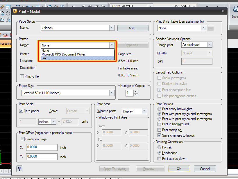

Is there in any way that we can print dwg to pdf? Kindly advise us.
Thank you and regards
Saiful
Is there in any way that we can print dwg to pdf? Kindly advise us. Thank you and regards Saiful
Sir/Madam,
Please proceed in the order specified below.
1. Execute "plot"
2. Click on Printers and select Microsoft Print to PDF or any other PDF Printer
(For Windows 10, Microsoft Print to PDF driver is provided by default)
3. Set the rest of the print options as if you were printing on paper.
4. Click the OK button to start printing.
5. Printing is done as a PDF file rather than paper.
Thank you!
