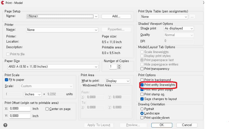

Is if possible to output all objects with the same line thickness if each objects has a different line thickness set individually?
Thank you for asking.
After the "plot" command, if you turn off the "print entity line weight" option in the window as follows and then output it, all lines will appear thin.
If this method doesn't work for you, please feel free to ask again anytime!
Thank you!
