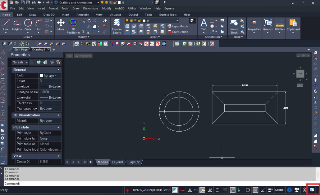

I'm using CADian, but I want to use the screen more widely. Are there any specific commands for that?
Thank you for asking.
As shown in the picture, there is a button at the bottom of the screen that allows you to view the screen more prominently.
You can either press that Button or use the command CLEANSCREENON/OFF.
Thank you!
