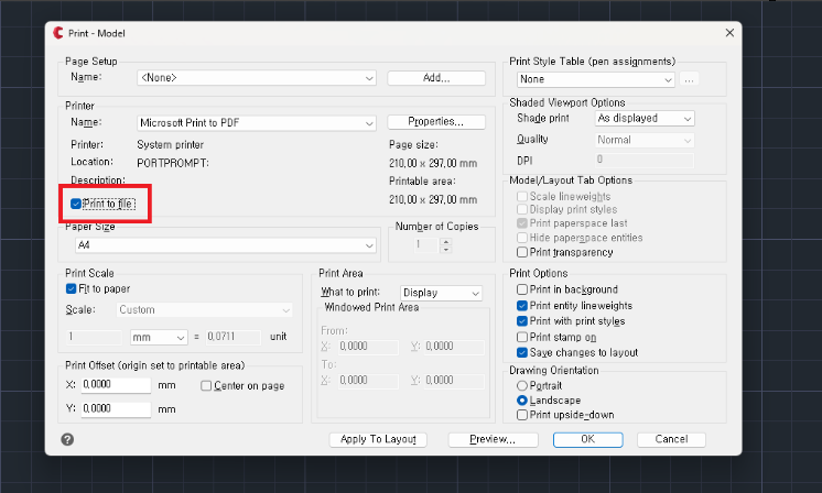

When saving as a PDF, it is saved as a PLT file.
Please provide a solution to this issue.
Thank you for asking.
Please check if the 'Print to File' option is selected in the plot command.
If it's checked like a photo, please uncheck it and try again.
Thank you!
