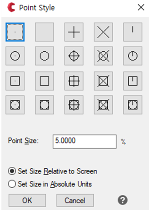

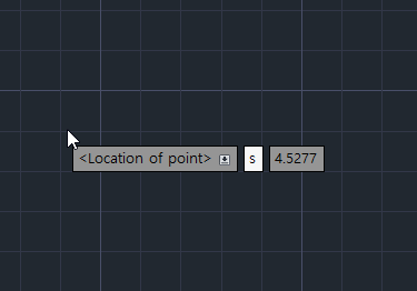

Hello, this is Cadian. I'll guide you on the issue you raised.
(1)Enter the 'point' command.
(2)In the generated
, type the alphabet 's' and press the Enter button.
(3)Click the first point on the top left and then click the confirm button.
Please proceed according to the given instructions. If the problem persists, please contact us again. Thank you.
