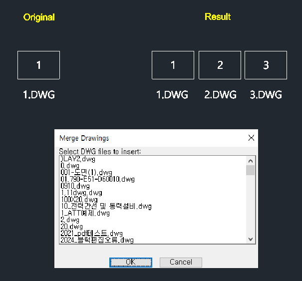

This tool allows you to import and append multiple DWG files into your current drawing sequentially.
  • Batch Insertion: Select multiple drawing files from the same folder to insert at once.
  • Sequential Placement: The selected drawings are automatically inserted one after another with a specified spacing (e.g., 100mm) to the right of the previous drawing.
  1. Type dwgmg in the command line and press Enter.
  2. A file selection window appears showing DWG files in the current directory.
  3. Select the files you want to merge.
  4. Click Insert Start (or similar confirmation button).
  5. The selected drawings are inserted side-by-side with automatic spacing in the current workspace.
