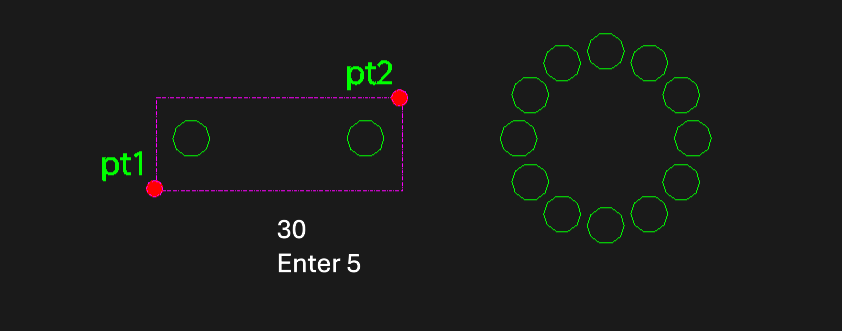

This tool allows you to select two circles and create rotating copies of them at a specified angle increment.
  • Paired Selection: Selects two circles at once using a window (two points).
  • Continuous Rotation: Automatically copies and rotates the selected pair counter-clockwise by the user-defined angle with each press of the Enter key.
  1. Type c2pa in the command line and press Enter.
  2. Click the First Corner (PT1) of the selection window.
  3. Click the Second Corner (PT2) to enclose the two circles.
  4. Press Enter to confirm selection.
  5. Enter the Rotation Angle (e.g., 30) and press Enter.
  6. Press Enter repeatedly to create copies at the specified angle intervals.
  7. Press Esc to finish.
