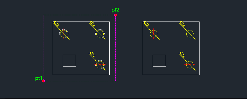

This tool allows you to quickly delete arcs within a selected area based on their diameter (or radius doubling).
  • Filter by Size: You can specify a diameter, and only arcs matching that size (based on their curve) within the selection window will be deleted.
  • Delete All: If no diameter is specified (by pressing Enter), all arcs within the selected area will be deleted.
  • Selection Method: Uses a standard window selection to define the area.
  • Input: Requires defining a selection window and optionally entering a diameter value.
  1. Type delarc in the command line and press Enter.
  2. Click the First Corner (PT1) of the selection area.
  3. Click the Diagonal Corner (PT2) to complete the selection window.
  4. Enter the Diameter of the arcs you want to delete and press Enter.
    • Alternatively, press Enter without typing a value to delete all arcs in the selection.
  5. The matching arcs (or all arcs) within the area are deleted.
