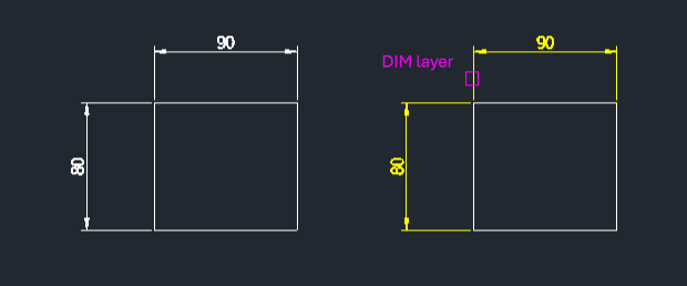

This tool automatically moves all dimension objects in the drawing to a specific layer named "DIM".
  • Layer Organization: Quickly standardizes drawings by placing all dimensions on a dedicated layer.
  • Auto-Layer Creation: If the "DIM" layer does not exist, it is created automatically.
  • Default Color: The "DIM" layer is set to color 2 (yellow) by default if created.
  • Batch Process: Affects all dimension objects in the current drawing space.
  1. Type dtodim in the command line and press Enter.
  2. All dimension objects are immediately moved to the DIM layer.
    • If the layer didn't exist, it's created with color 2.
