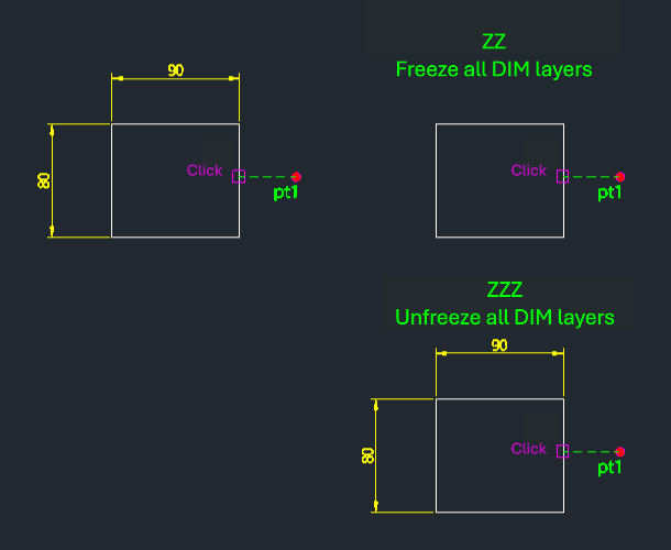

This tool provides a shortcut to quickly manage the visibility of dimension layers.
  • ZZ: Instantly freezes all layers whose names start with "DIM" (e.g., DIM, DIM1, DIM_TEXT). This is useful for quickly hiding dimensions to clear up the drawing view.
  • ZZZ: Instantly unfreezes (thaws) all layers starting with "DIM", restoring their visibility.
  • Target Layers: Specifically targets layers with the "DIM" prefix.
  1. To Freeze Dimensions:
    • Type zz in the command line and press Enter.
    • All layers starting with "DIM" are frozen.
  2. To Unfreeze Dimensions:
    • Type zzz in the command line and press Enter.
    • All layers starting with "DIM" are unfrozen (thawed).
