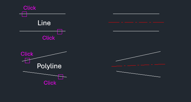

This tool draws a horizontal center line precisely between two selected lines (or polylines).
  • Automated Midpoint: Calculates the midpoint between two vertical or near-vertical lines to draw a horizontal bisector.
  • Auto-Layer: Automatically places the line on the CENTER layer.
  • Compatibility: Works with both standard lines and polylines.
  • Input: Requires selecting two line objects sequentially.
  1. Type mid in the command line and press Enter.
  2. Click the First Line.
  3. Click the Second Line.
  4. A center line is automatically drawn horizontally between the two lines on the CENTER layer.
    • Note: This specific LISP might not include the layer creation routine itself, so it's recommended to use it within an environment where the CENTER layer exists or use a comprehensive LISP package that handles layer creation.
