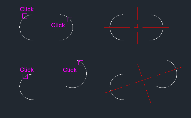

This tool draws a center line connecting the centers of two selected arcs.
  • Simplification: Makes it easier to draw a center line between two arc features without manually finding their center points first.
  • Auto-Layer: Automatically places the line on the CENTER layer.
  • Input: Requires selecting two arc objects sequentially.
  1. Type 2acen in the command line and press Enter.
  2. Click the First Arc.
  3. Click the Second Arc.
  4. A center line is automatically drawn between the centers of the two arcs on the CENTER layer.
