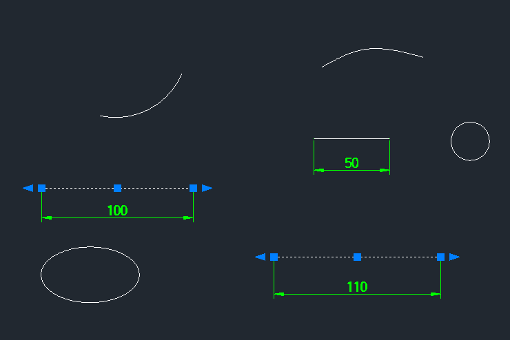

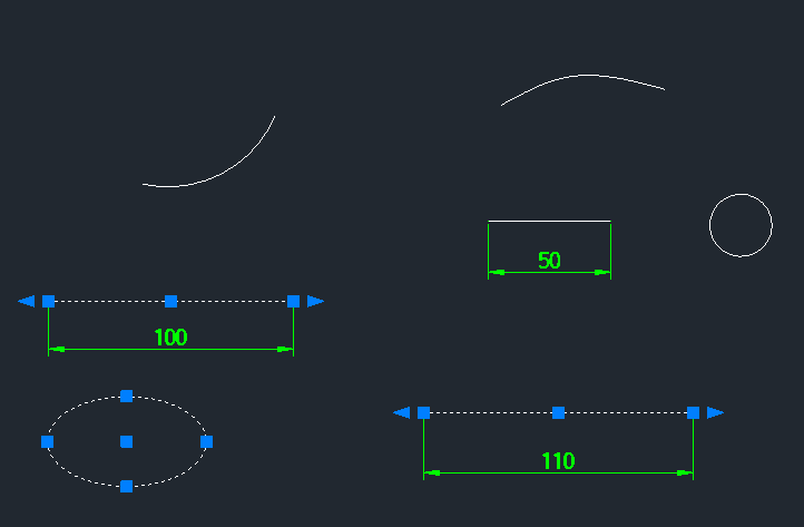

2/ Description : This tool selects objects (Lines, Circles, Arcs, Ellipses, Splines, Polylines) based on their length relative to a specified value.
  • Conditional Selection: You can select objects that are equal to, greater than (or equal), or less than a specific length.
  • Workflow: Input a reference length, choose a condition (Equal, Greater, Less), and then select the area to search.
  • Supported Objects: Works on various geometry types that have a length property.
  1. Type bylen in the command line and press Enter.
  2. Enter the Reference Length (e.g., 100).
  3. Choose a Condition Option:
    • 1: Select objects with length Equal to the reference.
    • 2: Select objects with length Greater than or Equal to the reference.
    • 3: Select objects with length Less than the reference.
  4. Select the Area (using a window or crossing selection) to search for objects.
  5. Objects meeting the length criteria within the selected area are highlighted/selected.
