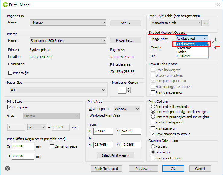

Plotting speed
If your plotting speed is too slow, please check the settings as below.
=> Please set the 'Shade print' as 'As displayed'.
